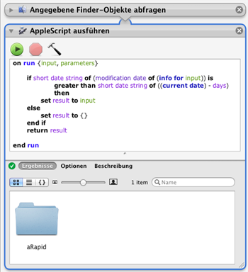

Etwa in so…
Verzeichnis wurde modifiziert

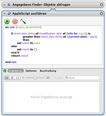

Verzeichnis wurde
nicht
modifiziert

on run {input, parameters}
if short date string of (modification date of (info for input)) is greater than short date string of ((current date) - days) then
set result to input
else
set result to {}
end if
return result
end run

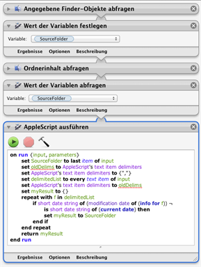

_mäuschen
30.12.12
18:17
set SourceFolder to last item of input
set oldDelims to AppleScript's text item delimiters
set AppleScript's text item delimiters to {","}
set delimitedList to every text item of input
set AppleScript's text item delimiters to oldDelims
set myResult to {}
repeat with f in delimitedList
if short date string of (modification date of (info for f)) is short date string of (current date) then
set myResult to SourceFolder
end if
end repeat
return myResult
end run
und
Automator
mit
Variablen
nutzen.
